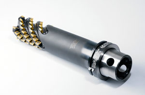

Kennametal’s KM4X™ spindle-connection system performs in high-speed, low-torque or low-speed, high-torque conditions. The increasing numbers of shops that machine very hard metals, like titanium, have a dilemma. Machinists there have the same objective with titanium that they have with any other material — maximal rates of metal removal, for optimal shop productivity. But, the hardness of the metal means they have to balance the demands of low cutting speeds adopted to reduce thermal effects with the necessity of much higher cutting forces.

Kennametal offers the following as an example: An indexable helical cutter with 250 mm (9.84 in.) projection from spindle face, 80 mm (3.15 in.) in diameter, generates 4,620 Nm (3,407.5 ft. lbs.) of bending moment, and less than 900 Nm (663.8 ft. lbs.) of torque.
