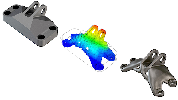

This is the original design of the bracket used in the GE Aircraft challenge. The re-designed bracket was required to fit within this volume and meet load requirements while reducing the overall weight of the part.

This is an image of the “topology optimized” bracket design generated by Frustum's software.

This is the GE Aircraft engine bracket redesigned by Frustum and manufactured by Quickparts on a 3D Systems ProX DMP 320 printer. The new part passed all the load condition requirements specified by the GE challenge and stayed within the same footprint while reducing weight by a staggering 70%.
