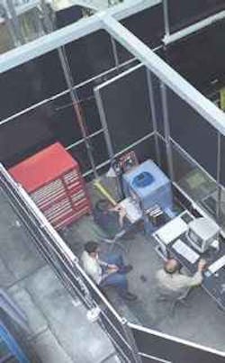

The Universal Robot Controller lets shops with multiple robots train users on only one type controller, saving both time and expense.
