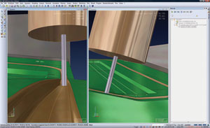

Acrylic tooling for a turbine blade sealing device, programmed using Vero Software’s VISI Machining 5-Axis.

Future AM’s task was to produce a mating pair of complex aerodynamic components that seal together by means of a multi-axis dovetail groove that followed an elaborate path around the face of a turbine blade. It was clear at the quotation stage that the original CAD data was not compatible for manufacturing, and would require manipulation, as it contained both corrupt surfaces and steps that were un-machinable.
After initial consultation with the client and Vero’s 5-Axis support engineers, it was agreed that the model could be adapted better to suit the relevant machining strategies. The original solid model was provided as a native SolidWorks file and loaded directly into VISI for editing.
Mike Sullivan, Future AM’s director and project manager, explained: "The main reason for re-modeling was because the original groove geometrical form was built using a series of complex combined surfaces that included the side wall and upper and lower radii.
“Simultaneous 5-axis machining is very reliant on surface quality and continuity,” Sullivan continued; “the tool movements multiply any imperfections. Using the powerful multi-surface editing capabilities inside VISI, it was possible for me to deconstruct the geometry and re-model the blends in the complex groove to suit 5-axis dovetail machining, yet still provide an acceptable sealing solution within the customer’s original design."
Once approved, the new model was used in-house, where it was also necessary to add side-extension surfaces for machining purposes, add clamping blocks, and create capping surfaces for finishing the master insert faces.
The machining was performed on a standard Bridgeport VMC 1500 XP3 with an integrated Nikken tilting rotary table and a 1,2000-rpm head. As the finished components were machined in PTFE, the relatively high surface feeds/cutting speeds were only restricted by the continuous 5-axis tilt and rotation speed of the table. Because of the way that the groove followed the hilly terrain, finish machining was reminiscent of a rodeo ride. The machining envelope in this instance was around 400 mm3, although the company machines and inspects in excess of 2 meters.
