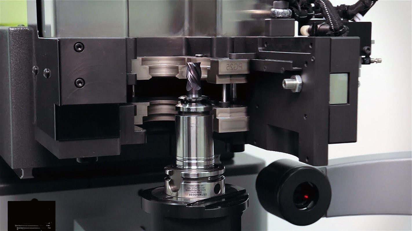

Look for equipment compatibility — Equipment manufacturers have taken up the toolroom-integration challenge, especially because it offers their customers enticing advantages, but to load, preset and unload tools from an automatic clamping unit a machine tool must conform to the automation system. In the development of an automated tool presetting concept, toolholder OEM REGO-FIX used its powRgrip clamping system toolholders and a modified PGU-9500 automatic clamping unit to work with a Universal Robots articulated robot arm and a Zoller presetter.
Modifications included adding pneumatic cylinders to the clamping unit; altering door designs, valve and button-control systems; and wiring the system to a central terminal block to which the robotic PLC attached. With those changes, the robot could signal the REGO-FIX PGU-9500 unit to perform press-in and press-out cycles for the powRgrip tool loading/unloading process; move holders to the presetter for tool-offset measurement; and place completed tool assemblies into a finished tray.

Choose tooling that produces reliable measurement data — Data accuracy underlies every aspect of toolroom automation, and anything that interferes with that accuracy complicates the process. Unfortunately, today’s heat-shrink toolholding systems, for example, can complicate the assembly stage of automated tool preparation. By the time an automated system writes measurement data to the RFID chip on a tool in a heat-shrink toolholder and the assembly arrives in a robot's cart, the tool cools and shrinks by several microns, which means its settings are inaccurate.
To account for that dimensional change, the automation system either must wait for the tool to cool before measuring it or use a complex compensation formula to account for changes in size. The wait increases production time, and the compensation formula introduces error-prone complications that can translate to workpiece rejects.
To avoid these problems entirely, shops may choose a mechanically based clamping system such as REGO-FIX powRgrip, which yields ready-to-use cutter/toolholder assemblies with or without automation.
