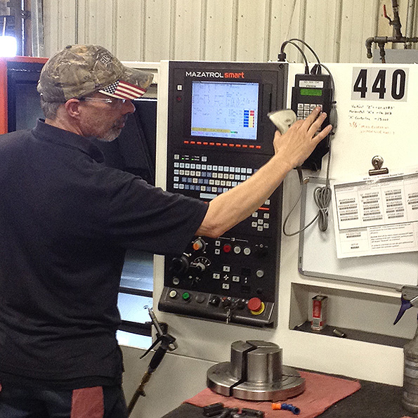

GEM Manufacturingrsquos programmer Sean Svajcsik enters a downtime reason into the eNETDNC processquality control application

That Kaizan event led GEM to invest in an eNETDNC system for the shop, to address inefficiencies with CNC program transfers and file rev control. eNET’s file rev control tools, like the Smart File Compare feature for edited-uploaded programs, ensure that GEM’s master programs will not be lost or even edited without a manager’s approval.
Using eNET also allowed GEM’s operators to call and send programs quickly, right from the machine control. Previously, they had relied on a time-consuming process of cueing programs remotely from a CAM system, which involved the operators having to leave their machines to launch the programs up from a workstation computer.  That cumbersome process came to a critical point when the CAM systems were unable to transfer programs to GEM’s new Mazak, Makino, and Haas CNC machine tools.
By contrast, the eNETDNC system worked flawlessly for all of their machines and control types.
