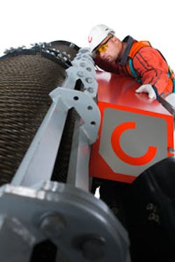

"The service life of hoisting wire ropes is a key element in maintenance expenses. Wire ropes are costly, and changing them is a time-consuming task. We have clearly extended the life of the wire ropes by optimizing the pulley rope angles in the hook housing, making them as small as possible to reduce the wear and tear on the wire ropes. Additionally, another innovation in SMARTON is its ability to predict the replacement interval of the wire ropes based on actual operating condition," explains Kiviniitty.
