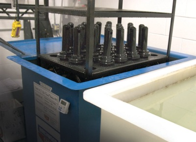

Command Tooling Systems puts a black-oxide finish on more than one-third of the toolholders it produces, and it was outsourcing the process. That outsourcing typically added three days to the manufacturing process. However, the company now uses a seven-tank, 100-gallon Tru Temp in-house blackening line that cuts the process to 34 min. The system also gives the tooling company more control over the process.

Working with Birchwood Casey, Command Tooling configured its finishing line to operate with an overhead hoist that also serves a recently installed bead-blasting system. Both the finishing line and the bead-blasting system are set up in a room near the shop's machining operations, and are run by one operator.
Toolholders go through the bead blaster to remove heat treat scale, then are loaded onto customdesigned racks that accommodate 39 to 137 toolholders. The overhead hoist moves the racks through the black-oxide process line. Once they are blackened, the toolholders move back to the main shop for finish machining. The system keeps product handling to a minimum.
