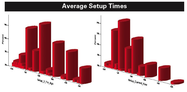

Respondents in the survey indicated what their setup time(in hours) is for an average job this year compared to what it was three years ago. The median value of all shops showed a 25 percent reduction to 1.5 hr today from 2.0 hr three years ago. Benchmark shops, the shops that are in the top 20 percent in terms of productivity and profit, reported a 54 percent decrease to 1.3 hours from 2.8 hours. Digging a little deeper, we found that 55 percent of all shops that provided setup time information reduced their setup times by 50 percent to 75 percent over the last three years.
Looking at actual hours, 83 percent of all reporting shops report current average setup times of 3.0 hr or less (see attached charts), compared with the 82 percent that reported average setup times of 5.0 hr or less three years ago.
Those numbers tell us that more than 80 percent of all shops have been able to reduce their average setup times by about 40 percent over the last three years. While the survey does not tell us is how those shops achieved those reductions, we can look at the tools and techniques that are used by the shops with the greatest setup time reductions (50 percent to 75 percent).
