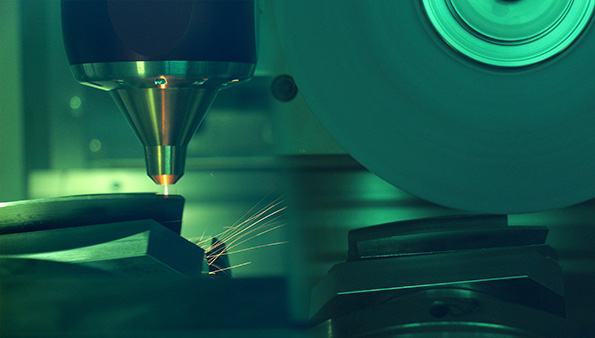

Mazak’s VC-500 AM hybrid multi-tasking machine combines full five-axis machining functions with additive technology, especially for manufacturers requiring optimal part finish and high accuracy. It was introduced at the International Machine Tool Show in September 2016. (Mazak Corp. photo)
Nonetheless, these technologies are quite similar. Sometimes, both CNC machining and additive manufacturing are sometimes used in the same project and even on the same parts, a combination broadly referred to as “hybrid manufacturing.” This combination, and the various machines developed to perform hybrid manufacturing, allows manufacturers to introduce 3D printing to an established CNC shop with relative ease. Due to the limitations of additive manufacturing (materials and size, to cite two), many machine shops and factories are understandably hesitant to phase out their CNC operations entirely.
