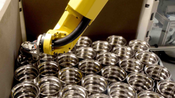

Once the finished bearing races have been automatically measured, the hard-turned components are engraved and then placed in shipping containers by the robot.
Fully Automated Machining … and Tending, Inspecting, and Packaging

Wardell and Buck proceeded to install a cell consisting of the Okuma 2SP-250H, a single Equator, an engraving machine, and a Fanuc M20iA 6-axis robot. In practice, the lathe’s two part carousels are loaded with raw workpieces, approximately 300 parts. The lathe’s dual gantry loaders feed the spindles and place finished parts on a chute leading to a conveyor for pickup by the robot.
The robot places the part on the Equator for measurement and, if acceptable, it transfers the part to the engraving machine, and then finally boxes/palletizes the finished pieces.
