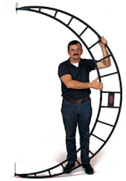

Starrett also produces custom micrometers ideal for shops machining wind turbine and blade components. These extra-large micrometers include the company’s No. 724 Big Mic that measures in a range of 72 in. to 78 in. and has interchangeable anvils.
