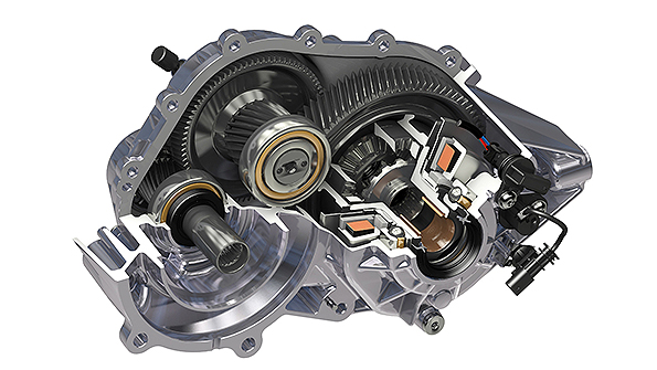

GKN Driveline lightweight electric axle weighs 20.2 kg. At 457 mm long, 229 mm wide, and 259 mm high, it is compact enough to be installed in smaller vehicles electric or hybrid vehicles.

As detailed by the developer, the single-speed design has a transmission ratio of 12.5:1, reducing the electric motor speed in two stages. It generates up to 2,000 Nm and 70 kW of additional torque and power, which is enough for a vehicle’s “pure electric” mode to accelerate up to 125 km/h, and for an all-wheel drive (AWD) mode that accelerates faster than conventional mechanical AWD systems.
When hybrid operation is not required, an electromechanically actuated dog clutch disconnects the e-machine from the driveline, minimizing losses at higher vehicle speeds.
Also, GKN has optimized gear and bearing arrangements for optimum efficiency, NVH (noise, vibration and harshness) and durability.
