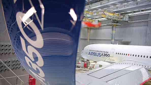

The Airbus A350 is designed with carbon-fiber composite wings that have a 213-ft span, and wing tips that curve upward over the last 14 ft, to increase cruising speed and maximum speed.

The wings of the A350 are among the CFRP design elements, with a 213-fit wingspan that is the largest ever produced for a single-deck widebody aircraft. The wing tips curve upward into a saber-tip shape for the last 14 ft, with a a 31.9° sweep angle that is intended to increase cruising speed to Mach 0.85 and maximum operating speed to Mach 0.89.
The first component of the wing being produced is a spoiler hinge bracket. The design of the wing includes a new, trailing-edge high-lift system with dropped-hinge flap that makes it possible for the gap between the trailing edge and the flap to be closed with the spoiler.
