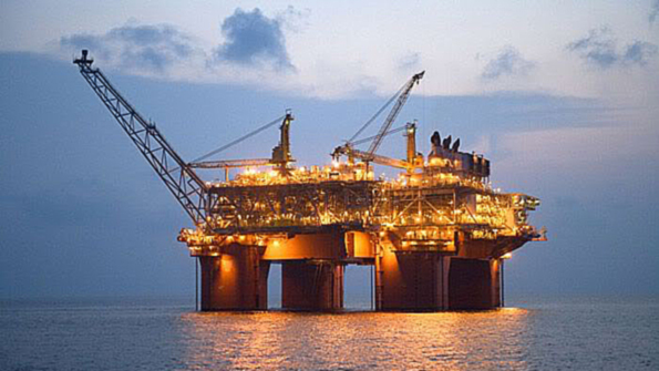

Drilling, production, processing machinery Platform 110 km offshore, 500 m deep 60,000 barrels/day of oil, 1.4 million cu3m/day of gas

Technip, a construction engineering group, was awarded a contract as part of a joint-venture to engineer and build a tension leg platform (TLP) for Sabah Shell’s TLP Malikai Deepwater Project. This will be a fully manned platform, to be installed 110 km offshore at a water depth of approximately 500 meters. The TLP will weigh approximately 26,000 metric tons, incorporating topsides and a hull.
The "topsides" will consist of surface installations for drilling and/or production, and/or processing of offshore hydrocarbons. It will able to process 60,000 barrels/day of oil and 1.4 million cu3m/day of gas.
The tendons will be fabricated in the U.S., and transported to Malaysia for installation at the Malikai field.
