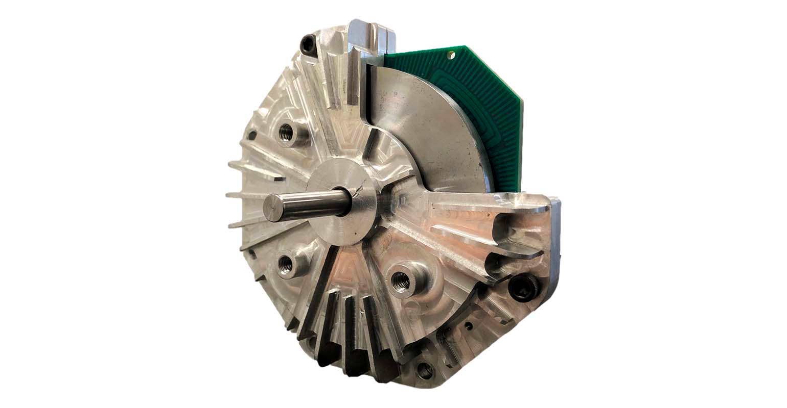

An rotary electric motor with a PCB stator in place.

Stators are stationary components of a rotary motor that transfer electric energy through the controller to the motor shaft, defining its speed and torque. While conventional stators are comprised of coiled wire, which generate heat and absorb the stress of the operation, ECM PCB Stator Technology’s innovation is to replace the copper windings with a much lighter, printed circuit board – applying the concept that engineers frequently use to link individual components of electrical systems.
