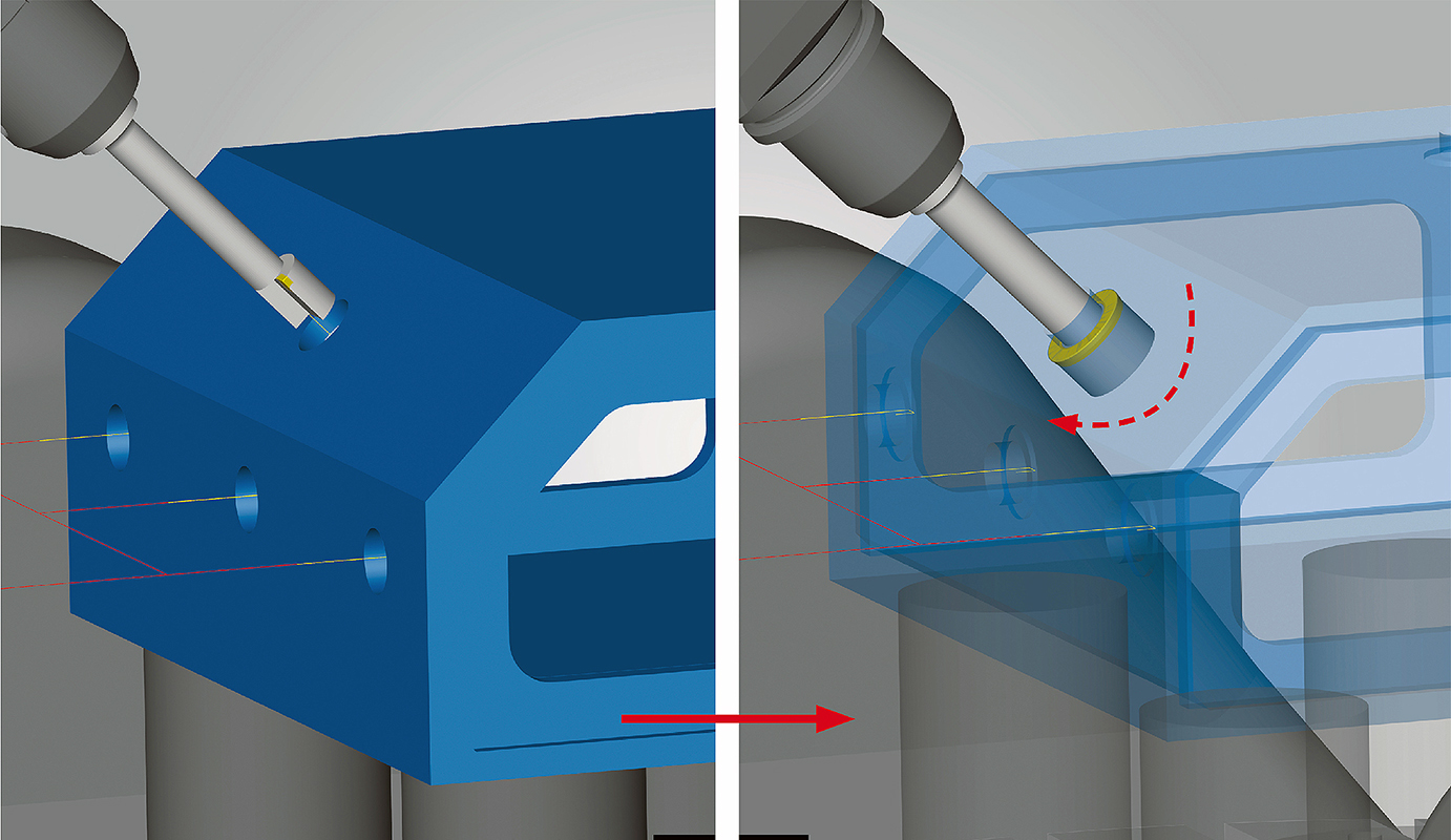

New “2.5D Back Boring” strategy in hyperMILL® 2023 reliably avoids collisions when inserting and retracting tools on the back side of a hole.

To ensure the highest level of safety while providing reliable programming when back boring, a new 2.5D Back Boring machining strategy permits back boring tasks to be programmed on machines with different kinematics, conveniently and easily. Toolholders and inserts, as well as monobloc tools, are displayed one-to-one in the virtual machine and checked for collisions.
Now, programming the controller for countersinking, deburring and milling tools on the once inaccessible back side of a hole can be done with ease.
