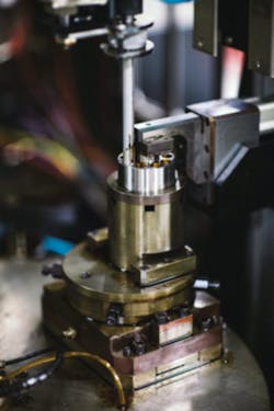

The work envelope of the honing machine shows the air-bearing index table in the foreground, the robot to the left, honing spindle and tool at upper center, and air gage at the right.
One critical detail about the Sunnen machine is a patented, new ‘smart tooling’ technology that servocontrols the force on a honing machine's tool feed system. This and other machine automation capabilities, such as robotic part indexing and in-process air gaging, have created a new reality at Waltz, a company that looks at machining through the eyes of a precision grinding shop.

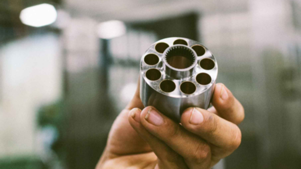

The heart of the pump, called a cylinder block or rotor, starts as a turned blank up to eight inches in diameter. Then, nine circumferential piston bores from 0.1875 to 1.5 in. (4.8-38.1 mm) diameter are roughed in on a machining center, and the part may be heat-treated.
The piston bores are not through holes, but have small kidney-shaped slots cut through the bottom. Some designs call for heat treating, use of bronze bore liners, or bronze plating on the bottom of the part, its running face. Liners may be cast in or produced on Waltz's screw machines, then anchored into retaining grooves with a ballizing process or swaging.
"Nine bores are common to most all pump designs," Waltz explained. "We buy the raw stock and manufacture the cylinder block blank complete. We also manufacture several different parts that work within the final actuator assembly, including the pistons and 'slippers.' The pistons have a total diameter tolerance of 0.000120 in. (0.003048 mm), while the bore IDs on the cylinder block have a total diameter tolerance of 0.000240 in. (0.006096 mm). We must also maintain tolerances of 0.000020 in. (0.5 µm) for bore roundness, 0.000040 in. (1 µm) straightness, 4-8 µin (0.1 - 0.25 µm) Ra bore finish, and less than 3 µin (0.07 µm) surface on the pistons. We have three Zeiss CMMs that can scan the piston bores at various levels for cylindricity, too. All these parts are serialized, traceable to the material and processes used to create them.

Waltz had been using standard horizontal honing technology from Sunnen, where outcomes are heavily dependent on the operator's skill. "The operator would hone one bore, clean the part, air gage it at three different levels and then at 90 degrees bottom/middle/top to see if there's any issue, such as taper at the bottom of the bore which would have to be feathered out," he explained. "There's a tremendous amount of back-and-forth to complete nine bores, and if you blow one bore, you've scrapped a part valued at several hundred dollars.
Based on measurements taken by the air gage (shown in the photo), the honing tool is automatically adjusted to maintain a precise diameter. Compensations can be made for taper, barrel shape, or bell-mouth conditions too by adjusting the spindle’s stroke position or length. The gage has auto-mastering capability. At an adjustable interval, the mastering ring (dull chrome at top of probe) moves down the probe over the air jets and the gage zeroes to the master.

Waltz's new SV-1015 vertical CNC honing machine has a single 5-hp AC spindle with 10-hp servo stroking system and X-Y air bearing table. The operator loads the workpiece in a dedicated fixture that uses the part's kidney slot as a locating feature.
After each bore, the table indexes 90 degrees to an Etamic air gaging station where the necessary readings are taken and stored. If the bore passes inspection, the table moves the part to a robot that indexes it for the next bore, duplicating this routine eight times to complete a part. A fixed position master set ring inside the machine's work envelope ensures correct gage calibration for current environmental conditions.
