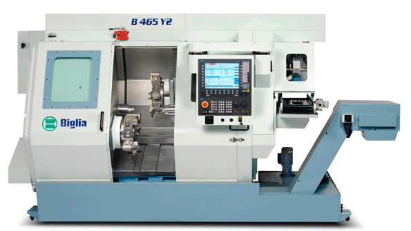

Biglia has equipped its turning centers of the Quattro series with the Sinumerik 840D sl CNC control The individual machines have 11 to 15 NC axes

Recently, Italian machine tool manufacturer Biglia introduced its multi-functional 'Quattro' series of turning centers, offered with Siemens’ Sinumerik 840D sl CNC as the control platform. The mechanical concept, it noted, together with the scalable control, provides users with a valuable array of standard turning and milling operations, and the result is increased flexibility and higher speeds for machine operators.
The "Quattro" series are multifunctional turning centers developed for reliability and performance power. The machines are available in versions featuring 11 to 15 CNC axes, and intended for different turning diameters (e.g., 45, 52, 65, 71, and 80 mm).

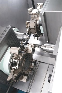

The turning centers from Biglia have two spindles and two independent tool turrets for simultaneous machining.
The two opposing spindles form a distinctive feature of the "Quattro" series: the design allows the workpiece to be machined from two sides, which reduces the machining time. Also, the second spindle can be moved linearly in two directions — lengthwise and crosswise —which provides some leeway in the case of additional milling operations, but it can also enhance the productivity and flexibility of the shop by making the machine available for automatic workpiece unloading. Two turrets, mounted on the y-axis, ensure proper positioning of the necessary tools.
This innovation means it is possible for the operators to initiate not only rotary processes, but also to work on prismatic workpieces – including polygons, according to the developers. Dealing with everything in one setup reduces cycle times, they emphasized, and enhances accuracy.  The machines are developed according to a modular concept that ensures flexible application options – from the universal CNC lathe, to complete machining of complex workpieces with powered tools (c- and y-axis.)

On the Biglia turning centers, the control was equipped with the Sinumerik Operate user interface, so the operation is “simple and intuitive,” the developer noted.
Three different methods of parts programming are possible: Classic ISO code programming; programming with the help of the integrated ProgramGuide with graphical support of the selected cycles; and the new, two-channel ShopTurn with graphical 3D simulation. The user is led through the cycles, step-by-step, whether for simple metal removal, drilling, thread cutting, pocket milling, groove milling or engraving.
More sophisticated programming cycles for complex contours also are possible. The "Program Sync" function for automatic synchronization of the machining programs via two channels ensures a significant increase in machine productivity. The control is equipped with a 15" monitor and integral keyboard.
