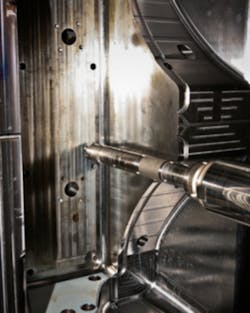

Preparing to rough a deep mold cavity on Redoe Mold Ltd.’s new Toshiba VBM equipped with an advanced Ingersoll Inno-Fit extension and and Ingersoll button cutter. Despite cavity depths up to 18 inches, the Inno-Fit extension provides enough rigidity to hold 0.001-inch tolerances on dimension and run-out over these extreme depths. Redoe machinists say the Ingersoll tooling package has doubled the capacity of the new machine.
