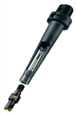

Vibrations stem from several machining variables, including long overhangs, the combination of high spindle speeds and low feedrates, hard materials and depths-of-cut that may be either too great or, conversely, too shallow, or working with thin-structured parts. Parts have become more complicated, and machining operations today are required to be faster without allowing for the repositioning of workpieces. So tooling with long overhangs increasingly are used to reach all the surfaces to be machined in one mounting. That tends to increase vibration. However, a rule-of-thumb that helps to squelch undue vibration is that when total tool length, from the gage line to the lowest point on the cutting edge, exceeds 4 to 5 times the diameter at the gage line, tapered or tuned tool adaptors should be used.
For example, inside Sandvik Coromant's (www.coromant.sandvik.com/us) Coromant Capto damped milling adaptor, a heavy tuning bar is suspended on rubber bushings and surrounded by a proprietary oil. When variations in cutting force cause the tuning bar to vibrate, the dampening system is activated, and the movement energy of the bar is absorbed into the tuning system.
