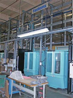

A Fastems palletizing system feeds work to Kitamura machining centers at Aluminum Precision Products. Aluminum Precision Products constantly looks at ways to improve efficiencies and reduce cost through lean manufacturing, ...

The cell is 27.2-m (89.2 ft.) long, and has 42 pallets. Most pallets carry aluminum tombstones that the shop manufactures itself.
