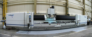

The new Bertsche X-Flex FMS replaces three machining centers and handles all expectations for a manufacturer supplying large components for an aircraft OEM
The Bertsche X-Flex FMS is a very large machine but a thoroughly flexible operation: it has two different work zones and multiple design adaptations that allow the aircraft supplier to produce short-notice critical parts with zero tolerance for error, or delay.
