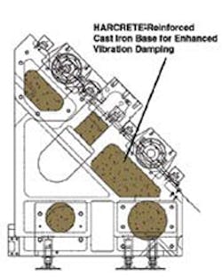

Hardinge Inc. says “Yes.”
Hardinge (www.hardingeus.com) is well known for its rigid machine bases made from Harcrete, a polymer concrete mixture.
However, as machine sizes continue to grow, Hardinge finds that using Harcrete bases for bigger machines makes them too heavy, Don Thomason, an application engineer at Hardinge, said. So, for its larger size machines, Hardinge developed a base design that has reduced weight, yet with the same levels of rigidity and dampening qualities as a Harcrete base.
Hardinge still uses Harcrete for its big machines, but it is not the only component of the base. The company starts with cast iron, then uses Harcrete to fill and to reinforce critical areas that are prone to vibration. The company conducted extensive research to determine the key vibration areas in its bases.
