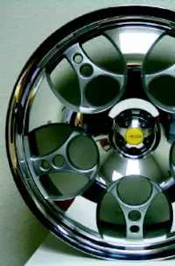

There aren't a lot of machine tools made specifically for manufacturing alloy wheels. Most of what's available are adaptations of existing equipment modified with a few extra features. Taking a different approach, a machine tool builder and one of its distributors consulted with 14 major wheelmakers to determine exactly what the industry needed. The builder then designed and built, from the ground up, equipment for machining alloy wheels.
At the top of the wheelmaker wish list was the ability to increase throughput, control and contain chips, improve part quality/tolerances, and run practically maintenance free 24/7. Armed with this knowledge and input from distributor Ellison Machinery Co., Mori Seiki developed the AZL 2400 and the AFM 2400 machines for wheel-manufacturing cells.

A prime cell
For the first cell operation at Prime Wheels, an AZL 2400 completely machines the brake side of wheels. A robot then loads them into an AFM 2400 for drilling in the second operation. Lastly, another AZL 2400 cuts the wheels' street-side surfaces.
Prime Wheels is one of the first shops to install Mori Seiki's new wheel-manufacturing equipment. The Carson, Calif., company has four cells, each doing three wheel operations and consisting of two AZL 2400s, an AFM 2400, and a Fanuc robot loader. One AZL is for the first operation, the AFM does the second operation, and the other AZL does the third operation. Since incorporating these cells, Prime has increased throughput for 20-in. wheels by 15%, and its time spent on preventative maintenance has been cut in half.
In the first cell operation, the AZL cuts the complete brake-side of the wheel. This includes brake clearance, mounting-pad surface, and center pilot bore, which fits onto the vehicle hub. Pilot bores are crucial because all the wheel tolerances and subsequent operations reference off them and the mounting surfaces. The machine also cuts the wheel O.D., which entails the tire-seat and drop areas. (The drop is the part of the wheel between the inner and outer tire seats).
This first operation, for Prime, controls cycle time. The company determines the cell's throughput by this operation's machining time, when the majority of material is removed. For 15 or 16-in.-diameter wheels, first-operation machining time is about 55 sec, and 20-in.-diameter wheels take around 90 sec.
The second operation at Prime is drilling. Wheels load into the AFM's fixture, locate off the mounting face and pilot bore, and stay in position with swing clamps. The machine drills five or six lug holes and the valve-stem hole and performs other operations, such as counterboring, on the back of the wheel.
For the third operation, an AZL identical to the one in the first operation machines wheels on the street-side. A center locator pin, which matches up to the center hub bore, accurately positions the wheel for machining. Generally, this is the shortest of the three operations, unless it involves a full-face-machined wheel.
If this is the case, Prime uses the machine's four axes to turn the face while simultaneously doing O.D. work. For shops not doing full-face-machined wheels, Mori Seiki offers an ASL 2400 two-axis machine.
In addition to machine tools, Prime's cells have in-process gaging that feeds real-time data to the machines so they can adjust to keep wheels within tolerance — all without operator intervention. Also, there are vision systems that recognize and orientate wheels properly.
A cell controller lets Prime monitor cells from a remote location via an ether-net connection. The shop manager checks if machines are running and sees current shift status for parts produced or rejected. And the controller indicates where cell idle times are.
