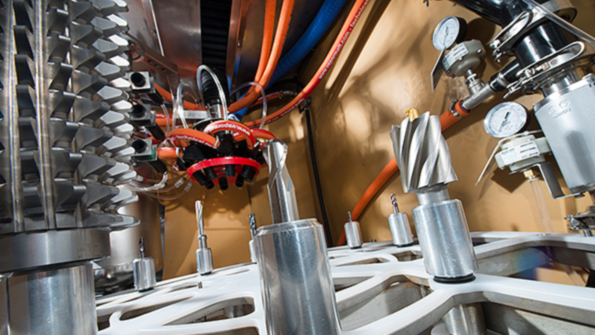

The Sabre wet blasting method improves the cutting quality for a range of tools without compromising controllability. The nozzle focuses blast guns on the faces and cutting edges so total coverage of tools is ensured.

The availability of programmable gun crowns enable tool manufacturers to extend tool operating life, improve surface quality, and increase production capacity. Programmable gun crowns are available that increase the number of blasting parameters that can be programmed for edge preparation, so users can achieve a wider range of radii and k-factors on increasingly complex designs of cutting tools.
As many as eight blast nozzles, each fully adjustable, can offer a range of processing angles. An automated system can give the user precise control over the K factors and edge radii required to increase tool life.  This means that with a single gun crown, programmed via a HMI, a customer can hone and finish a range of different tools, each with different K factors and radii, without having to manually change gun angles for different recipes which is a time consuming task for any manufacturer, particularly those involved with low volume batch production of special tools.
Vapormatt recently launched its new wet blasting system, the Vapormatt Sabre, developed in response to small- to medium-volume manufacturers’, coating centers’ and R&D facilities demand for an economical, high-performance wet blasting tool to increase the quality output on a range of cutting tools, without compromising controllability.
The nozzle formation of the Sabre focuses blast guns on the faces and cutting edges to deliver controllable results.  Total coverage of tools is ensured, offering edge radii within 0.0002 in. (+/-5 micron) tolerance of specification and a much improved surface for coating adhesion.  Because it carries an option to fit both Y- and X-axis nozzle arrangements, the Sabre offers customization opportunities and hybrid functionality.
Round shank tools, ranging from 0.118 in. to 1.81 in. (3 mm to 30 mm) diameter and 1.85 in. to 12.08 in. (46 mm to 307 mm) in length, can be processed but so too can cutting inserts and the Sabre can hold up to 4 Wendt or 3 Manz trays at a time.
