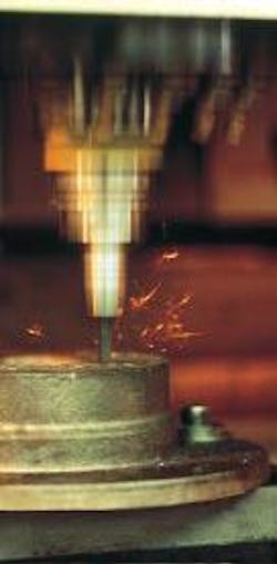

Combining new coatings with microfine-grain carbide materials and HSK toolholding helps manufacturers in ultra-high-speed machining in dry and near-dry conditions. Here, a high-performance carbide drill from Guhring dry machines cast iron brake parts.

The first commandment of dry machining concerns holemaking. Can a shop perform all operations dry, especially hole drilling? This is important, because it would be illogical to perform most cutting operations dry, or near-dry, then use coolant to drill holes.
Of course, turning or milling operations are the easiest to convert to dry machining. In these operations, cutting edges are exposed and chips leave the cutting zone quickly, having little contact with the workpiece and tool. The chips, therefore, serve as a medium to dissipate heat. On the other hand, chips are not so easily flushed out in a drilling operation, allowing heat to build up quickly in the confined depths of the hole. This also applies to operations involving taps, fluteless taps, and reamers.
