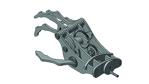

Solid Disassemble is a new model-prep function available in Mastercam X9 that takes an assembly and lays each body out in a single pane. The associativity between solids and toolpaths has been improved, according to the software developer, such that when bodies are edited only the toolpaths directly affected by the change in the solid body are marked “dirty.”

Solid Disassemble is a new model-prep function that takes an assembly and lays each body out in a single pane. The associativity between solids and toolpaths has been improved, according to CNC Software, such that when bodies are edited only the toolpaths directly affected by the change in the solid body are marked “dirty.”
