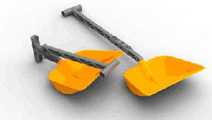

The collapsible snow shovel is designed by Senior & Dickson Ltd. for portability.
At this time of year, it’s wise to be ready for foul weather, at home and on the road. You may not want to shovel snow, but it’s good to have the right tools when the need arises. With a two-hinged handle, the Senior & Dickson collapsible shovel is designed by the plastic molding company with the aid of Vero Software specialty CAD/CAM tools, primarily for motorists. The manufacturers also expect the folding design to become a preferred tool at home, with its interchangeable shovel and fork heads.

VISI Modelling played an important part in the design of the original handle, and later in the process of strengthening it, by allowing senior design engineer Karl Freeman to add ribbing to the existing model. It also simplified the step of applying changes to the tooling inserts. Based on the industry-standard Parasolid kernel, VISI provided complete flexibility for constructing, editing, deforming, and repairing complex 3D data.
Chris Hodgson said that after running trials on the first prototype Senior & Dickson designers chose to add cross-ribbing to the shaft, to give it greater sideways strength, and to apply larger radii to remove a localized stress point that caused part failure during stress testing. “This was very easy to do in VISI because the software is not constrained by rules or a previous design history,” Hodgson offered. “You can simply jump back into the design process any point – you’re never stuck with a model that you can’t alter.”
Once the model had been finalized, the 3D tooling was designed using VISI Mould, and then manufactured from P20 pre-treated steel for the shovel head and H13 hardened steel for the handle and hinge. The shovel handle and folding mechanism are produced using a high-performance polycarbonate, and the shovel head is produced using a recycled polypropylene that is widely used and fatigue-resistant.
The shovel concept began with a wooden handle, but Senior & Dickson quickly concluded that this was impossible because of the angle required for it to connect to the head. At that point the designers turned to VISI to design the model for a molded handle. “We looked at using a cranked handle, and followed on from that with a folding design to make it much more convenient to store. At around two kilos the shovel is extremely lightweight, and with the folding handle it fits inside the smallest postage bag, keeping post and packaging delivery costs down for online customers.”
