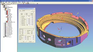

PAS CMM showing the result of feature extraction and inputting inspection parameters.
Inputting dimension and positioning data for each feature to be inspected.
Probes location
Probe motion optimization to reduce actual inspection time.
CMM machine simulation

PAS CMM does not generate reports, is not a CAD or CAD/CAM package, and doesn’t drive on-machine inspection the way the other packages do. All it does is take a 3D CAD model, any 3D CAD model, and generates DMIS code that can be used by any DMIS-controlled CMM. What makes it interesting is that it reduces the time it takes to generate the DMIS code by as much as 80 percent or more.
In an actual test on a potential customer’s part, PAS CMM reduced total time to develop a DMIS CMM program for that part from the seven working days the customer had spent to develop the program to less than six hours.
PAS CMM uses a combination of sophisticated feature recognition and probe control to almost completely automate the DMIS code generation. In this example, it took two minutes to import the file into PAS CMM, two minutes to build the alignment, one minute to specify machine orientation, three minutes for feature recognition extraction preparation, 30 minutes to complete feature extraction on 880 identifiable features, and four minutes to generate the CMM DMIS code. The bulk of the time was spent in manually entering inspection parameters and dimensions (geometric dimensioning and tolerance data). That took 300 minutes. Other tests using parts from other customers had the same results.
